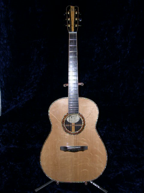

Ok, #1--An overall view of the front:

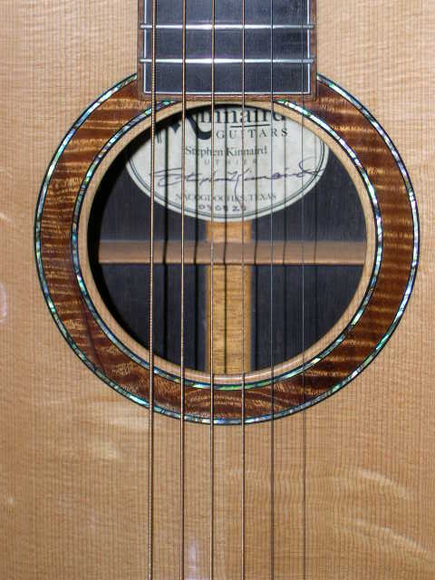

#2--A closer view of the rosette:

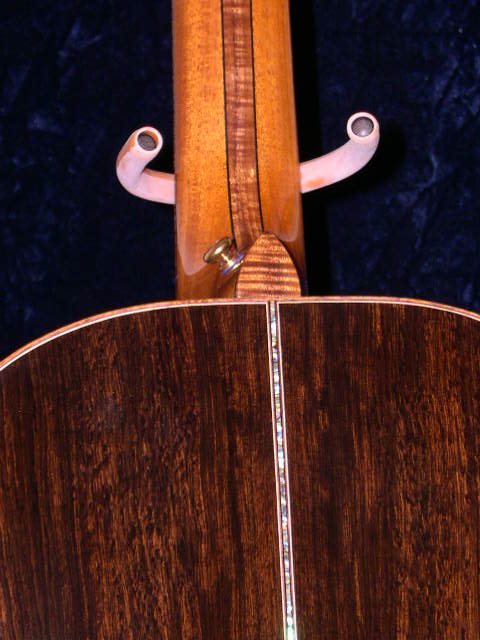

#3--A shot of the heel cap, back inlay (paua) and some of the neck:

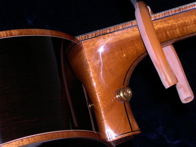

#4--The heel itself (bad shot, sorry!)

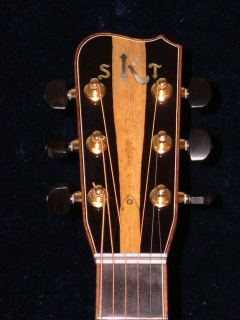

Finally, #5--The peghead-- bookmatched Blackwood, w/ black pearl in the sap area, and gold pearl in the black zones:
If you look closely, you can see the purfling on the body is Purpleheart and Holly. (Purple is the customer's favorite color. I thought one line wouldn't be too much.    )
Oh yes, the binding, heel cap, rosette and neck lam are Koa. The bridge is African Blackwood. It is a superior material for bridges!

Wooweee! that's pretty, Steve. It is all beautiful and I really love the head plate. Do you have a fret in your nut?   Maybe it's just my monitor.

I was wondering what that is on the nut also.
Can you please explain it?
It looks like a fret or purfling or something....

PostPosted: Thu May 24, 2007 3:41 pm
Very nice indeed! is that a laminated nut?

Beautiful,gorgeous,Stunning,amazing,lovely,Sweet,and not bad to look at! Seriously,Just a GREAT job Steve. The rosette stands out as one of the best I've seen. How did you make that nut?
PostPosted: Fri May 25, 2007 1:05 am
Steve, where are you? I too am anxious to know what is going on with the nut.
Oh, yes, there's a guitar built around the nut too. Yes, it's quite stunning. great work. Little things like using a sapwood tr cover are what polish it for me. Great work.
Now, about that nut...
PostPosted: Fri May 25, 2007 2:18 am
OK, guys! About that NUT....
But first let me thank you for your more than kind words. As you know, there is so much effort going into *just one project* that a shower of appreciation from one's peers is something almost necessary.
AND, you all do it so well!
Ok, the nut: this guitar is the second one for this customer, and since I had done this on his first guitar, it made sense to continue it...a theme of sorts.
Anyway, it's really simple, it's just Holly veneer sandwiched between BRW veneers (dark/light/dark) and then glued inbetwixt outer layers of white Corian. The whole sandwich is only 1/4" thick, and held together with epoxy. Next time, I'm gonna use bone saddle blanks as the outermost layers, just for the hardness.
